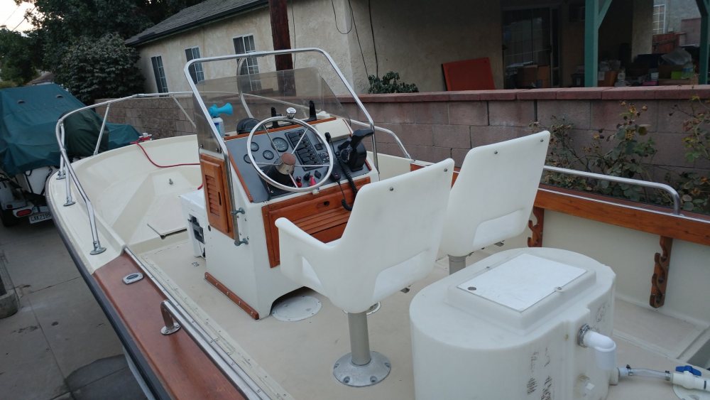

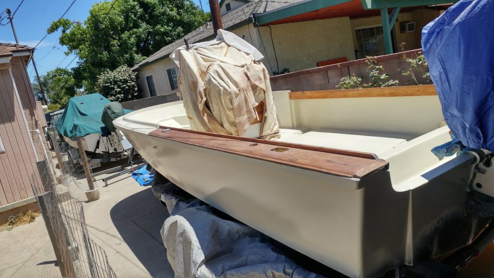

January 2, 20197 yr Author comment_4348 No, I need a good tough protective finish that is going to hold up to a marine environment. The finish should be a white, off white, maybe a grey. see the boat below. its off white. Link to comment https://success.kbs-coatings.com/topic/2355-teetop-paint-finish/#findComment-4348 Share on other sites Share on X Share on Facebook {lang="reddit_text" Share via email Share on Pinterest More sharing options... Report Share this post
January 3, 20197 yr comment_4349 Thanks for the pictures! That really helps us see what you see. KBS Top Coater would be absolutely ideal. Clean all surfaces really well with KBS Klean. Then apply KBS Top Coater in thin, covering coats. For marine applications like this, apply at least 3 coats. KBS Top Coater also does comes in all of the colors you suggested. Please let us know if that helps you out and if you have any additional questions. Link to comment https://success.kbs-coatings.com/topic/2355-teetop-paint-finish/#findComment-4349 Share on other sites Share on X Share on Facebook {lang="reddit_text" Share via email Share on Pinterest More sharing options... Report Share this post
