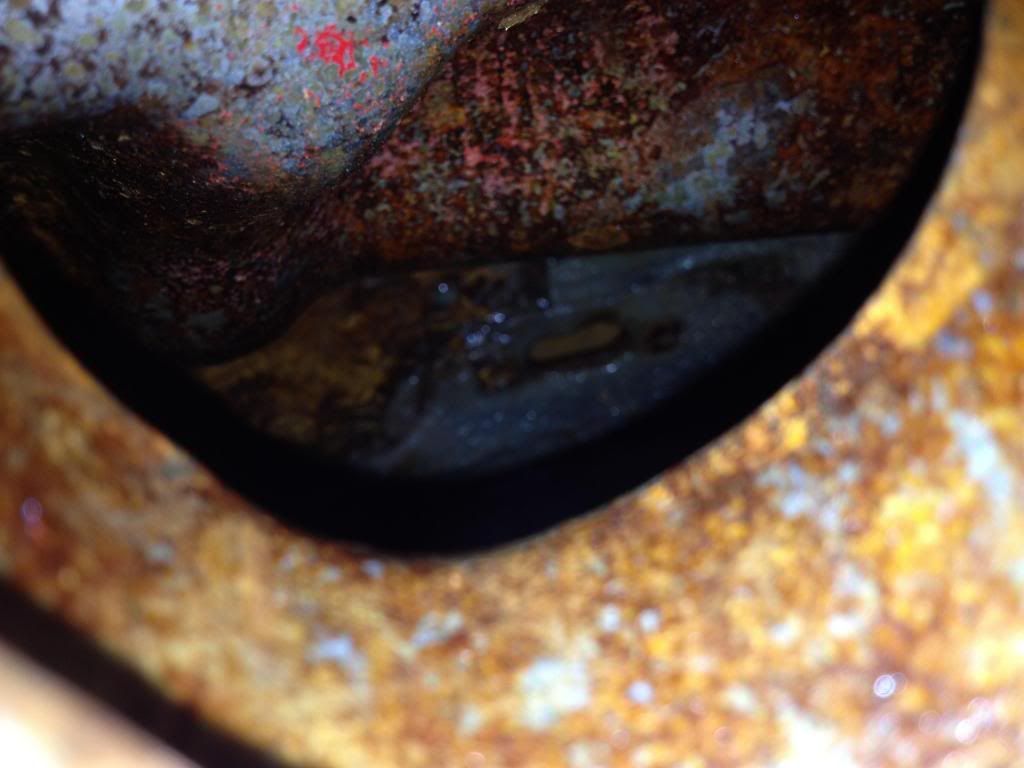

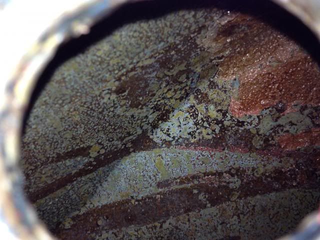

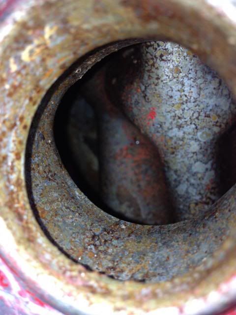

August 17, 201313 yr Author comment_2828 Here are the pictures before using any product: Link to comment https://success.kbs-coatings.com/topic/1620-making-tank-watertight/#findComment-2828 Share on other sites Share on X Share on Facebook {lang="reddit_text" Share via email Share on Pinterest More sharing options... Report Share this post

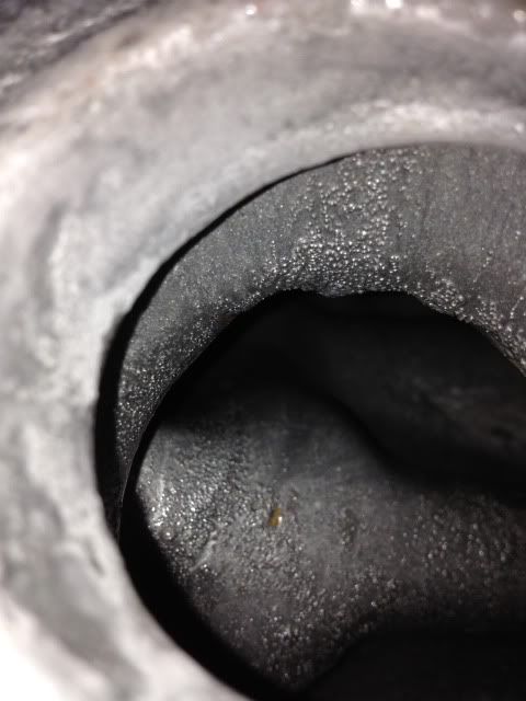

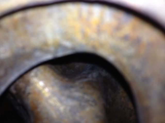

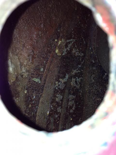

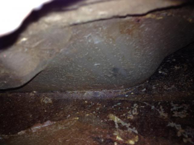

August 17, 201313 yr Author comment_2829 After KBS strip: Link to comment https://success.kbs-coatings.com/topic/1620-making-tank-watertight/#findComment-2829 Share on other sites Share on X Share on Facebook {lang="reddit_text" Share via email Share on Pinterest More sharing options... Report Share this post

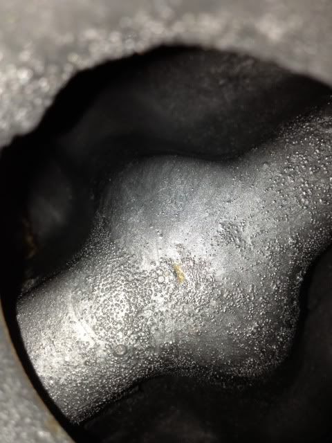

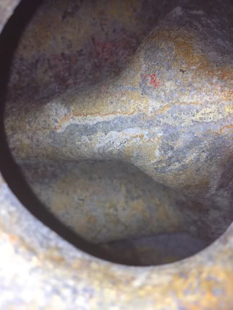

August 17, 201313 yr Author comment_2830 Some of the old liner still remains (the grey matter in the picture), tried more KBS strip, but it does not want to shift. I also used the jetwash on the insides today. Still in there. It seems it is bonded in there and is stuck very solid. I have had loads of chunks of old liner come out, but have a couple of spots in the bottom of the tank that I just cant seem to remove. As they are fixed in so firmly I was wondering if the new liner will still bond to the old remaining material? All I have left to do now is flash the tank with Rust Blast before I put in the new liner. Link to comment https://success.kbs-coatings.com/topic/1620-making-tank-watertight/#findComment-2830 Share on other sites Share on X Share on Facebook {lang="reddit_text" Share via email Share on Pinterest More sharing options... Report Share this post
August 17, 201313 yr comment_2831 The only thing I would suggest is try to remove the remaining old sealer with MEK. Then KBS Klean, RustBlast and Tank Sealer. Please let us know how that works for you. Link to comment https://success.kbs-coatings.com/topic/1620-making-tank-watertight/#findComment-2831 Share on other sites Share on X Share on Facebook {lang="reddit_text" Share via email Share on Pinterest More sharing options... Report Share this post

August 19, 201313 yr comment_2833 MEK is Methyl Ethyl Ketone. It is a commonly available solvent that can be used to strip out some coatings. You should be able to find it at your local hardware store. Link to comment https://success.kbs-coatings.com/topic/1620-making-tank-watertight/#findComment-2833 Share on other sites Share on X Share on Facebook {lang="reddit_text" Share via email Share on Pinterest More sharing options... Report Share this post

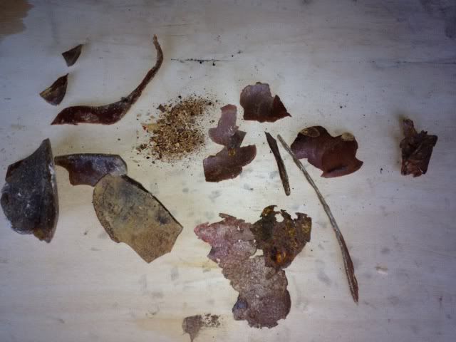

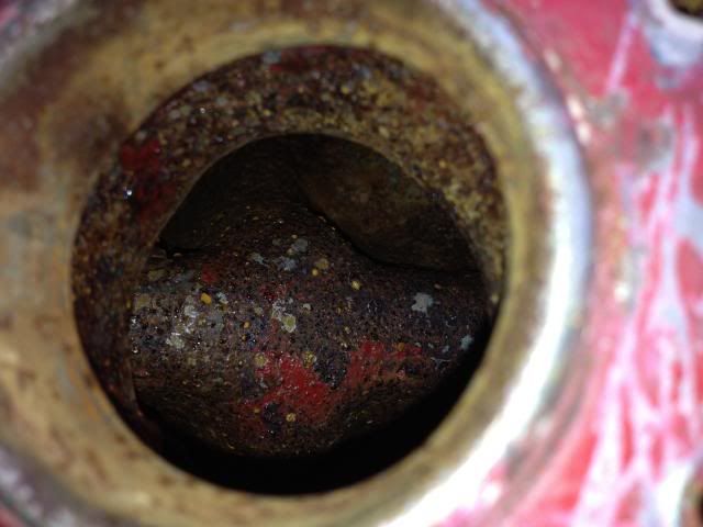

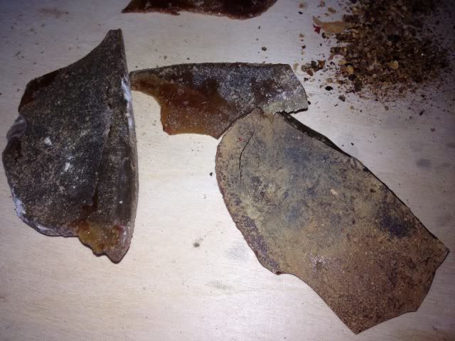

August 21, 201313 yr Author comment_2836 This is just some of the rubbish that has come out what liner would this have been, and is the previously mentioned chemical gonna be the best? Link to comment https://success.kbs-coatings.com/topic/1620-making-tank-watertight/#findComment-2836 Share on other sites Share on X Share on Facebook {lang="reddit_text" Share via email Share on Pinterest More sharing options... Report Share this post
August 23, 201313 yr comment_2839 We are not sure what old sealer that is. But, it is great that you got it out. Link to comment https://success.kbs-coatings.com/topic/1620-making-tank-watertight/#findComment-2839 Share on other sites Share on X Share on Facebook {lang="reddit_text" Share via email Share on Pinterest More sharing options... Report Share this post
August 23, 201313 yr comment_2840 At this point, clean the Tank with KBS Klean, etch with RustBlast and then proceed to the Tank Sealing Step. Please let us know how that goes for you and if you have any additional questions. Link to comment https://success.kbs-coatings.com/topic/1620-making-tank-watertight/#findComment-2840 Share on other sites Share on X Share on Facebook {lang="reddit_text" Share via email Share on Pinterest More sharing options... Report Share this post
August 23, 201313 yr Author comment_2841 so I don't need to worry about the last stubborn bits that are left in? Seem to be stuck in there for good Link to comment https://success.kbs-coatings.com/topic/1620-making-tank-watertight/#findComment-2841 Share on other sites Share on X Share on Facebook {lang="reddit_text" Share via email Share on Pinterest More sharing options... Report Share this post
August 23, 201313 yr comment_2842 If you can't get them out, then proceed with the KBS 3 Step Tank Sealing System. The Tank Sealer should be able to bite into those stubborn paint areas. Link to comment https://success.kbs-coatings.com/topic/1620-making-tank-watertight/#findComment-2842 Share on other sites Share on X Share on Facebook {lang="reddit_text" Share via email Share on Pinterest More sharing options... Report Share this post
August 23, 201313 yr Author comment_2843 Great. I've tried getting a long screwdriver in to lift or shift the stuck bits, but no luck. Will now proceed with the rust blast then the sealer (i have already run the KBS clean through). Link to comment https://success.kbs-coatings.com/topic/1620-making-tank-watertight/#findComment-2843 Share on other sites Share on X Share on Facebook {lang="reddit_text" Share via email Share on Pinterest More sharing options... Report Share this post

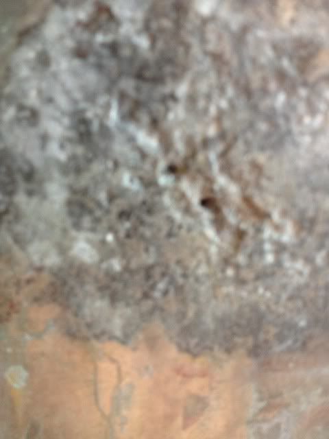

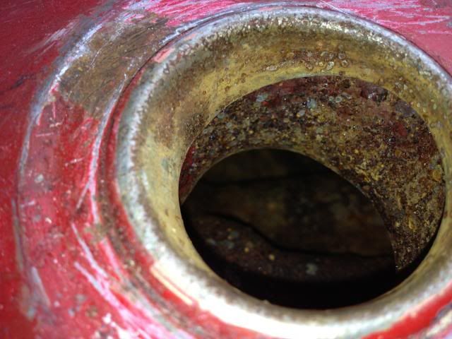

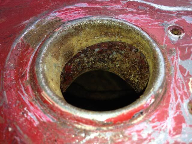

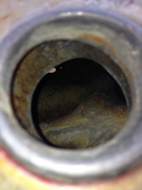

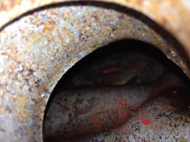

August 27, 201313 yr Author comment_2851 After Rustblast: note - pinholes on front of tank have now come through: Link to comment https://success.kbs-coatings.com/topic/1620-making-tank-watertight/#findComment-2851 Share on other sites Share on X Share on Facebook {lang="reddit_text" Share via email Share on Pinterest More sharing options... Report Share this post
August 27, 201313 yr comment_2852 Now you can patch up those holes with NuMetal Epoxy Putty. After that, you can proceed with the Gold Standard Tank Sealer. Link to comment https://success.kbs-coatings.com/topic/1620-making-tank-watertight/#findComment-2852 Share on other sites Share on X Share on Facebook {lang="reddit_text" Share via email Share on Pinterest More sharing options... Report Share this post

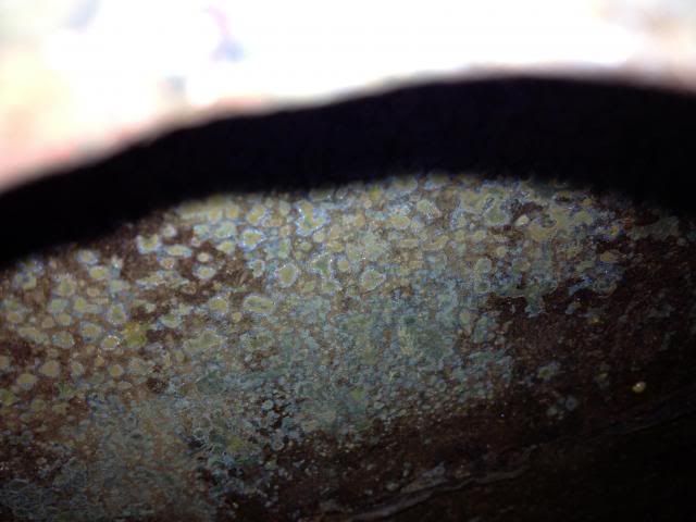

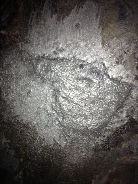

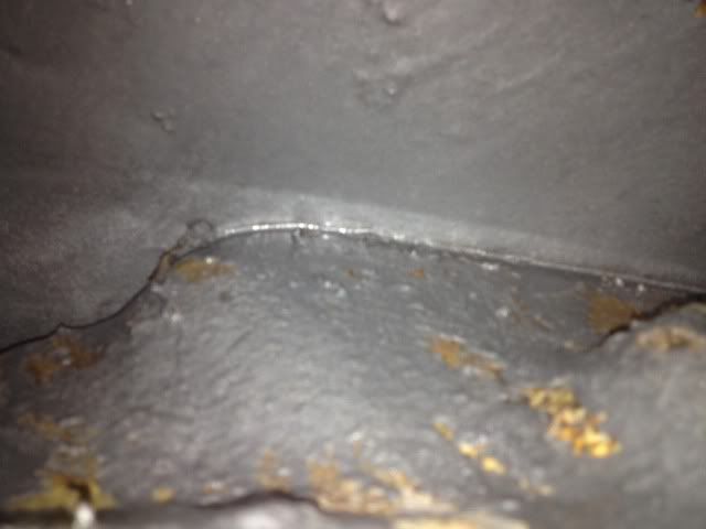

August 27, 201313 yr Author comment_2853 After tank sealer: I followed the instructions to the T for the tank sealer, but it seems there ot enough paint to go round as there a a few exposed areas as can be seen. Do I need to get an extra can of sealant to run round again to catch the bits that were missed? Link to comment https://success.kbs-coatings.com/topic/1620-making-tank-watertight/#findComment-2853 Share on other sites Share on X Share on Facebook {lang="reddit_text" Share via email Share on Pinterest More sharing options... Report Share this post
August 27, 201313 yr comment_2854 The cured Tank Sealer needs to be scuffed so an additional coat of Tank Sealer can stick to it. As long as you can do that, you can apply some more Tank Sealer. We have also had customers roll Fusion Self-Etch Primer around in the tank to etch the cured Tank Sealer and then put in another coat of Tank Sealer. Link to comment https://success.kbs-coatings.com/topic/1620-making-tank-watertight/#findComment-2854 Share on other sites Share on X Share on Facebook {lang="reddit_text" Share via email Share on Pinterest More sharing options... Report Share this post
August 27, 201313 yr Author comment_2856 In the instructions it said to use the included fabric/mesh along with the selant here it is done: Link to comment https://success.kbs-coatings.com/topic/1620-making-tank-watertight/#findComment-2856 Share on other sites Share on X Share on Facebook {lang="reddit_text" Share via email Share on Pinterest More sharing options... Report Share this post
August 27, 201313 yr comment_2857 Sounds good. Pinholes, small holes, and weak areas can be reinforced with BackBone. For larger holes, it is a good idea to use NuMetal Epoxy Putty. Link to comment https://success.kbs-coatings.com/topic/1620-making-tank-watertight/#findComment-2857 Share on other sites Share on X Share on Facebook {lang="reddit_text" Share via email Share on Pinterest More sharing options... Report Share this post
