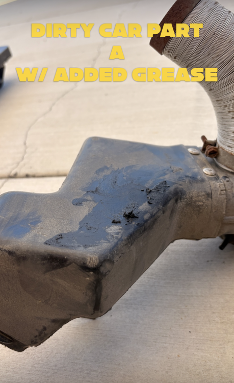

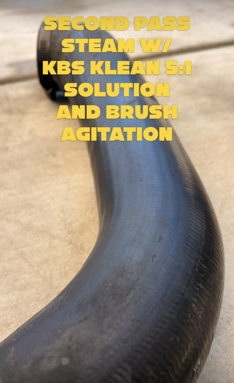

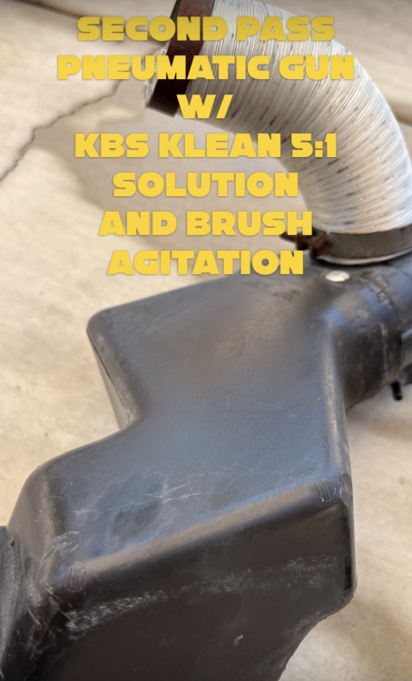

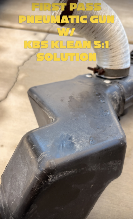

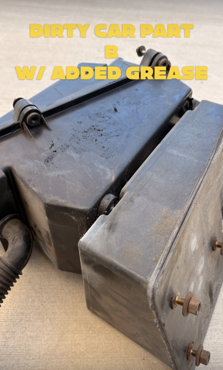

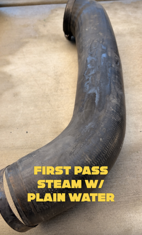

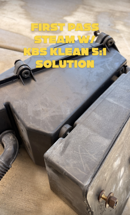

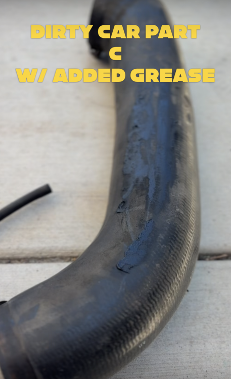

July 20Jul 20 Author comment_10519 I ended up testing a pneumatic degreasing gun ($15) and a steam machine ($114) and used 3 different dirty car parts to compare. I added some grease to each of the parts to make it a tougher job. For this part, I used the pneumatic gun with a 5:1 solution of KBS Klean. It did a good job but didn’t clean off the grease until I agitated it all with a brush and sprayed it again. This was a good result with little effort.For the second car part I used the steam machine which siphoned the same KBS Klean solution. This treatment was able to melt the grease away and get a good result in one pass but the sacrifice is time. The steam machine doesn’t produce much pressure so it takes a lot more time on one area to get it clean. And even though it only took one pass, agitating it with a brush and making a second pass produced a better result.The third test was to test the steam machine with plain water and this was the worse result out of the three. I would not recommend.Almost not worth posting until I agitated the part with a brush and made a second pass with the steam/KBS Klean solution again.My take on the topic is that KBS Klean AND agitation are key to getting the best results from either the pneumatic gun vs steam. For the money and similar results the pneumatic gun is a keeper.The steam machine is a bit fussy to work with and doesn’t have good pressure either. 🤙@OceansideBroncoII Link to comment https://success.kbs-coatings.com/topic/7664-kbs-klean-in-a-steam-cleaner/#findComment-10519 Share on other sites Share on X Share on Facebook {lang="reddit_text" Share via email Share on Pinterest More sharing options... Report Share this post
October 17Oct 17 comment_10531 Running the same greased-up parts through the pneumatic gun, the steam machine with KBS Klean, and the steam machine with plain water gives the next person working out of a garage a clear comparison to go by.Your results line up with the KBS Klean directions. On heavily soiled surfaces, a bristle brush or scouring pad speeds up the cleaning, and you retreat the surface with KBS Klean solution as needed until it is clean. That is the same brush-and-second-pass routine that gave you your best results with both tools. The plain water test coming in last shows how much of the cleaning the KBS Klean solution is doing.Since you are keeping water use down in the garage, two things to keep in mind with either tool:Do not let the KBS Klean solution dry on the part before rinsing. Rinse thoroughly with water and let the part dry.Hotter water makes KBS Klean more effective. Your 5 parts hot water to 1 part KBS Klean mix is the moderately soiled ratio. For heavy grease you can go as strong as 1 part hot water to 1 part KBS Klean.Before your next round of parts, we strongly recommend reading through the complete KBS Klean application directions linked below. The notes above are a quick orientation, not a substitute for the full directions.KBS KleanKBS Klean Application DirectionsThanks again for posting the comparison, and good luck with the restoration. Reach back out any time with questions. Link to comment https://success.kbs-coatings.com/topic/7664-kbs-klean-in-a-steam-cleaner/#findComment-10531 Share on other sites Share on X Share on Facebook {lang="reddit_text" Share via email Share on Pinterest More sharing options... Report Share this post
