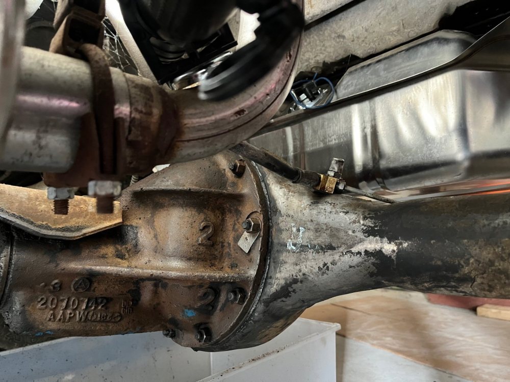

August 22, 20242 yr comment_6223 What products of yours will work the best to paint my rear diff and axle housing and prevent it from rusting? Link to comment https://success.kbs-coatings.com/topic/3605-rear-differential-and-axle-housing/ Share on other sites Share on X Share on Facebook {lang="reddit_text" Share via email Share on Pinterest More sharing options... Report Share this post
August 22, 20242 yr comment_6225 Are the rear differential and axle housing surfaces painted or bare at this point? Link to comment https://success.kbs-coatings.com/topic/3605-rear-differential-and-axle-housing/#findComment-6225 Share on other sites Share on X Share on Facebook {lang="reddit_text" Share via email Share on Pinterest More sharing options... Report Share this post

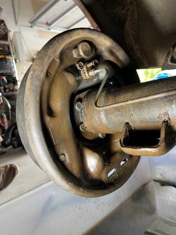

August 23, 20242 yr Author comment_6244 Combination of paint and bare/surface rust. In the process of cleaning using your KBS Klean product. The diff and brake backing plates were caked in grease and dirt. Link to comment https://success.kbs-coatings.com/topic/3605-rear-differential-and-axle-housing/#findComment-6244 Share on other sites Share on X Share on Facebook {lang="reddit_text" Share via email Share on Pinterest More sharing options... Report Share this post
August 23, 20242 yr comment_6247 After you finish cleaning well with KBS Klean, etch those surfaces with RustBlast. Rinse with water. Let dry. Then apply RustSeal. Always thin coats and at least two coats. Have a look at the RustSeal Directions and let us know what other questions you have for us. Link to comment https://success.kbs-coatings.com/topic/3605-rear-differential-and-axle-housing/#findComment-6247 Share on other sites Share on X Share on Facebook {lang="reddit_text" Share via email Share on Pinterest More sharing options... Report Share this post
