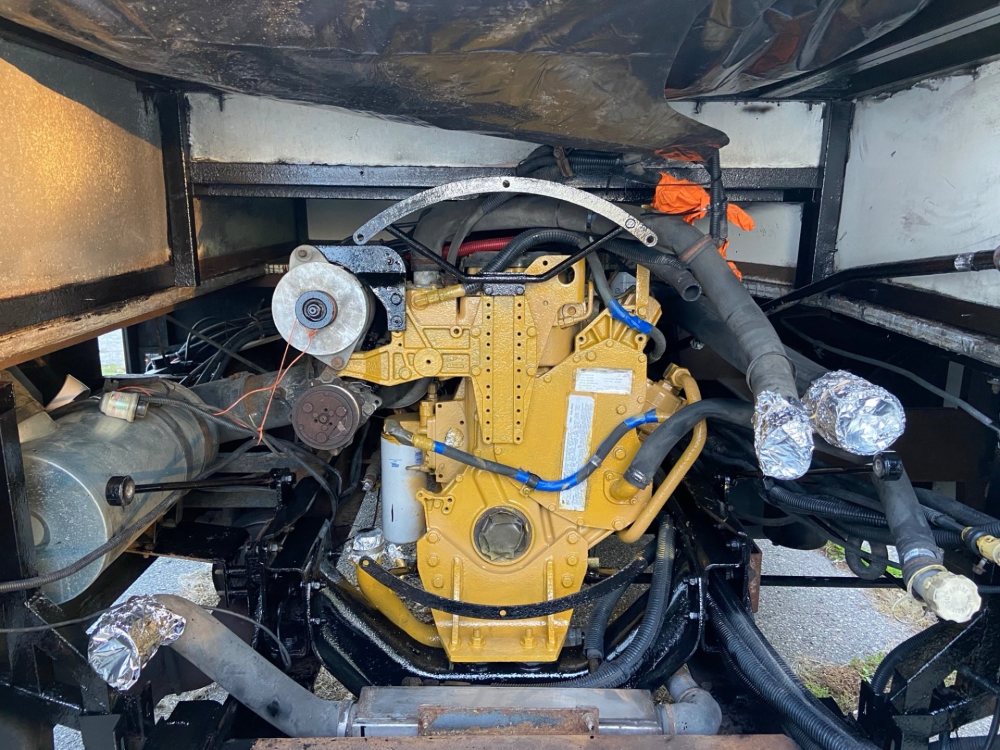

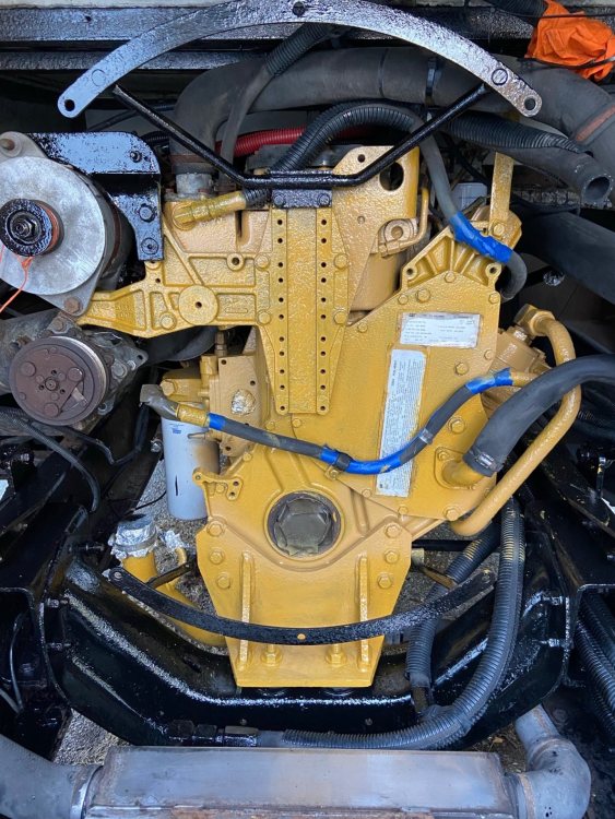

November 1, 20233 yr comment_5628 I'm painting the engine and part of the frame on my motorhome. I used motor coater on the engine and rust seal on the frame. The temps were in the 70s when I put the first coat on. I'm in Michigan, it's November. The forecast is showing highs in the mid 40s for as far as I can see. I need to put a 2nd coat on so I can get everything back together before winter. What will happen if I put the 2nd coat on with temps in the mid 40s? Link to comment https://success.kbs-coatings.com/topic/3061-second-coat-with-temperatures-in-the-mid-40s/ Share on other sites Share on X Share on Facebook {lang="reddit_text" Share via email Share on Pinterest More sharing options... Report Share this post

November 7, 20233 yr comment_5635 Thank you for the pictures. When the surface and ambient temperature are too cold, you run the risk of poor adhesion. But desperate times call for desperate measures, so do the best you possible can to get the surface and air temperature as close to 50F when doing the actual application. Link to comment https://success.kbs-coatings.com/topic/3061-second-coat-with-temperatures-in-the-mid-40s/#findComment-5635 Share on other sites Share on X Share on Facebook {lang="reddit_text" Share via email Share on Pinterest More sharing options... Report Share this post
