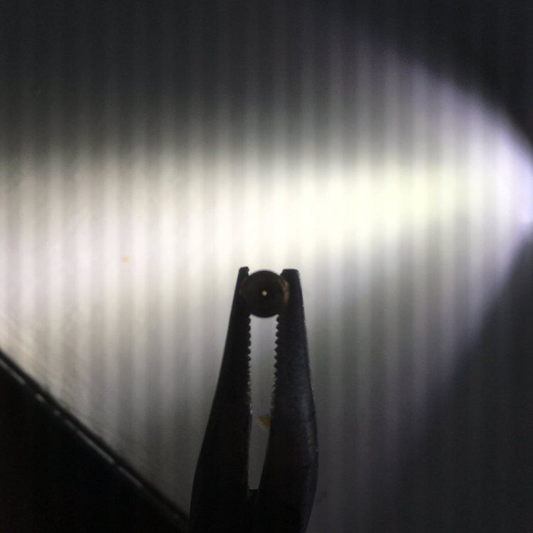

October 7, 20224 yr Author comment_5567 The issue occurred again yesterday. After it sat about 2 weeks, I ran it and it idled poorly and would die when increasing throttle unless the enrichment circuits were engaged. I removed the pilot jets (35) and as before, they didn't appear clear when viewed in front of a light. What's strange is I ran a thin metal wire through the jets, and didn't feel any resistance. It didn't feel like there was anything physically blocking the jet. Lightly blowing air through the jet cleared whatever was in them, and as before, the bike idled great without the enrichment circuits engaged. When I applied the liner back in March, I rolled the tank and emptied extra liner product per the instructions, and haven't noticed any obvious problems like peeling or bubbling when examining with a flashlight. I use a fuel with ethanol in it, and some reading suggests that could be a contributor. Just trying to rule items out and I'm curious if this is something possibly caused by the sealant. Wasn't able to get a great image, but here's what each jet looked like before being cleared. Thanks for taking time! Link to comment https://success.kbs-coatings.com/topic/3024-pilot-jets-consistantly-clogging-after-sealing-tank/#findComment-5567 Share on other sites Share on X Share on Facebook {lang="reddit_text" Share via email Share on Pinterest More sharing options... Report Share this post
October 7, 20224 yr comment_5568 If the Tank Sealer is fully cured, modern day fuels will not touch it meaning it will not release anything that would clog your fuel system. We sell thousands of Tank Sealer Kits a week so we can speak to that from testing and 15 years of experience with our customers. Yes, ethanol causes problem. It is probably best to try running no ethanol fuel and see what happens. Wish we could be of more help. Link to comment https://success.kbs-coatings.com/topic/3024-pilot-jets-consistantly-clogging-after-sealing-tank/#findComment-5568 Share on other sites Share on X Share on Facebook {lang="reddit_text" Share via email Share on Pinterest More sharing options... Report Share this post
