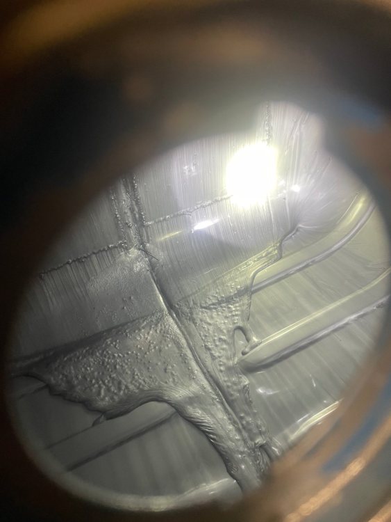

July 20, 20224 yr comment_5525 Hi there I just sealed my fuel tank and drained for as long as possible but still got some pooling in tank dose it need to be stripped and done again or will it be ok ?? it’s for diesel fuel. Link to comment https://success.kbs-coatings.com/topic/3006-david/ Share on other sites Share on X Share on Facebook {lang="reddit_text" Share via email Share on Pinterest More sharing options... Report Share this post
July 20, 20224 yr comment_5527 First, yes, that is a whole lot of pooling of the Tank Sealer. It would have been much better to keep rolling and turning the tank so all that excess Tank Sealer could have been evenly distributed over the entire inside of the tank versus just that section. Here is what you can do: 1) Put a shop vac (or similar) on the tank so you get air flowing inside the tank. 2) Add humidity to the room where the tank is curing. 3) Wait seven days and poke that area with an unfolded wire coat hanger (or similar). If it is soft, let the tank cure longer. If it has hardened up, then you are good. Please let us know if this helps and if you have any additional questions. Link to comment https://success.kbs-coatings.com/topic/3006-david/#findComment-5527 Share on other sites Share on X Share on Facebook {lang="reddit_text" Share via email Share on Pinterest More sharing options... Report Share this post
