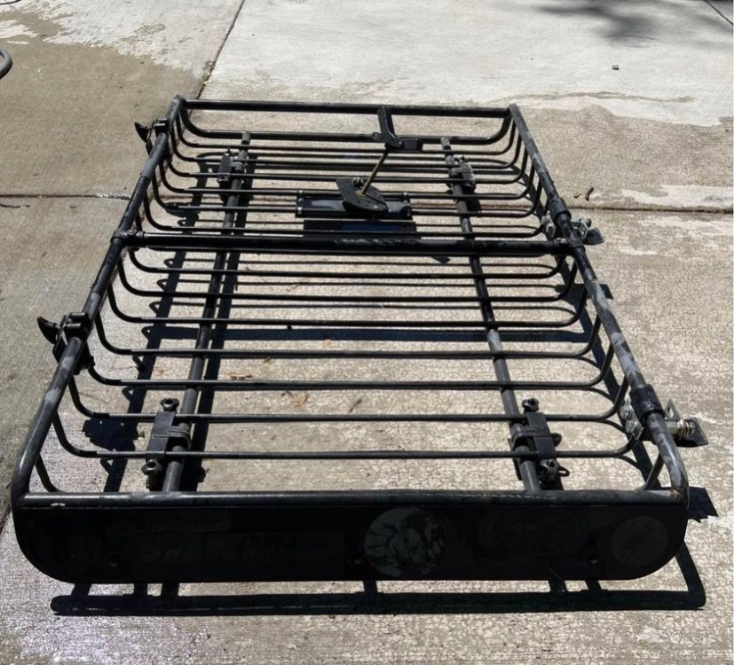

Jason Kendall Posted July 6, 2022 Report Share Posted July 6, 2022 I have a Yakima roof basket and it’s fading and developing surface rust. What product would you recommend to fix this to make it last? Quote Link to comment https://success.kbs-coatings.com/topic/3002-yakima-roof-basket-help/ Share on other sites More sharing options...

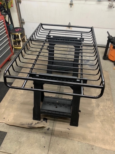

Jason Kendall Posted July 23, 2022 Author Report Share Posted July 23, 2022 [url=https://ibb.co/nC30Zgp][img]https://i.ibb.co/xHmsPCZ/654-F5-AF6-75-C9-4672-AD42-C021-CE41169-D.jpg[/img][/url] 1st coat went on very very nice! Laid it down thin with a brush. Now to wait for it to dry and flip it over. Quote Link to comment https://success.kbs-coatings.com/topic/3002-yakima-roof-basket-help/#findComment-5531 Share on other sites More sharing options...
Jason Kendall Posted July 24, 2022 Author Report Share Posted July 24, 2022 Almost done with the whole process. One more coat of blacktop and I’ll be finished! Quote Link to comment https://success.kbs-coatings.com/topic/3002-yakima-roof-basket-help/#findComment-5532 Share on other sites More sharing options...
Jason Kendall Posted July 24, 2022 Author Report Share Posted July 24, 2022 It’s very humid here today. After I’m done with the final coat would it be ok to open the garage door and allow it to better cure in the humidity? Quote Link to comment https://success.kbs-coatings.com/topic/3002-yakima-roof-basket-help/#findComment-5533 Share on other sites More sharing options...
KBS Coatings Posted July 24, 2022 Report Share Posted July 24, 2022 Yes, after the flow out, you can utilize the humidity (and some air flow) to cure the BlackTop. It looks so good! Nice work. Quote Link to comment https://success.kbs-coatings.com/topic/3002-yakima-roof-basket-help/#findComment-5534 Share on other sites More sharing options...
