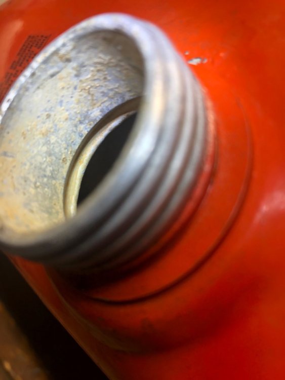

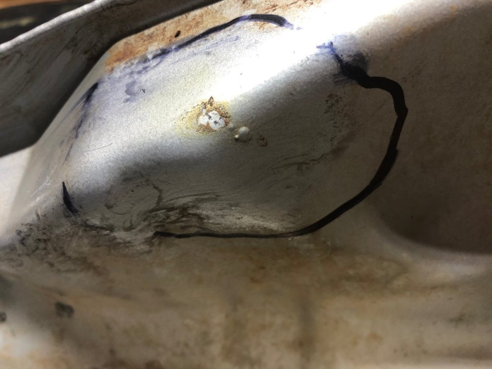

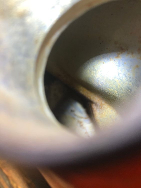

January 19, 20224 yr comment_5414 I bought an old bike with aluminium tank that had sat for a long time. It had some liquid stinky gas in it and was oozing molasses looking stuff by the petcock and a couple of pin holes. I soaked in fresh gas for a couple of weeks and then soaked with simple green water for a short time (also shaking with screws & bolts inside). The inside still does not look that clean. See pictures. Further back is what looks like a thin layer of the molasses looking varnish. Will the standard KBS tank sealer kit be adequate for cleaning and sealing a tank like this? If not, what other steps should I take? I'm not planning on repainting the tank so any cleaning solvents that eat paint are not desirable. Link to comment https://success.kbs-coatings.com/topic/2970-cleaning-and-sealing-old-aluminium-motorcycle-tank/ Share on other sites Share on X Share on Facebook {lang="reddit_text" Share via email Share on Pinterest More sharing options... Report Share this post
January 19, 20224 yr comment_5415 Yes, KBS Klean (which is included on our Tank Sealer Kits) along with a chain or nuts and bolts will remove the old fuel residue/varnish. It might take a bit of work, but it will remove that. Please let us know if that helps and if you have any additional questions. Link to comment https://success.kbs-coatings.com/topic/2970-cleaning-and-sealing-old-aluminium-motorcycle-tank/#findComment-5415 Share on other sites Share on X Share on Facebook {lang="reddit_text" Share via email Share on Pinterest More sharing options... Report Share this post
January 19, 20224 yr Author comment_5416 Thanks for the response. Should it look clean before sealing or will the sealer simply seal in some of this? Is the "stuff" in the filler neck residue or corrosion or both? Link to comment https://success.kbs-coatings.com/topic/2970-cleaning-and-sealing-old-aluminium-motorcycle-tank/#findComment-5416 Share on other sites Share on X Share on Facebook {lang="reddit_text" Share via email Share on Pinterest More sharing options... Report Share this post
January 19, 20224 yr comment_5417 Take a wire coat hanger and unfold it and then poke the areas. Once you do that, you will be able to tell if it is corrosion or gummy varnish type material. You want to remove any loose flaky rust and the gummy varnish before doing the RustBlast and Tank Sealer steps. Please let us know if you have any additional questions. Link to comment https://success.kbs-coatings.com/topic/2970-cleaning-and-sealing-old-aluminium-motorcycle-tank/#findComment-5417 Share on other sites Share on X Share on Facebook {lang="reddit_text" Share via email Share on Pinterest More sharing options... Report Share this post

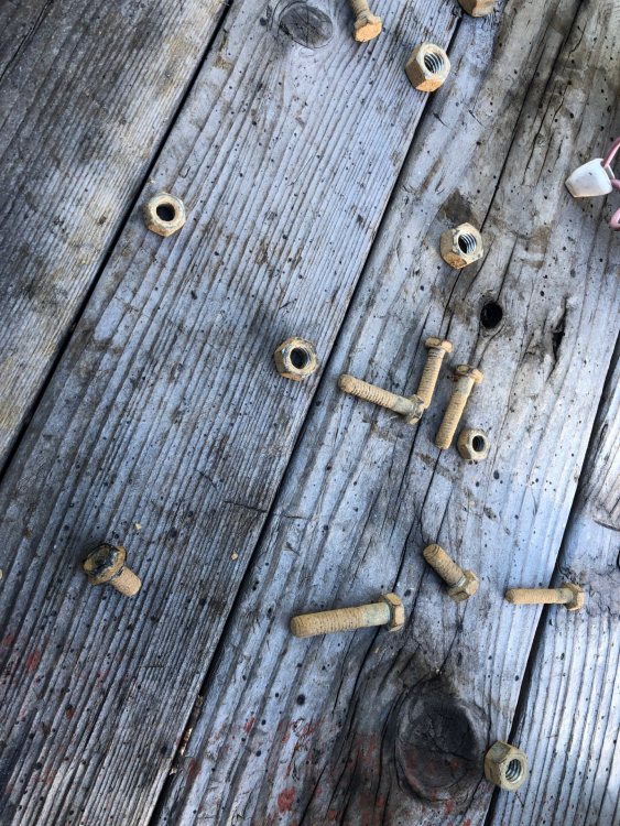

January 22, 20224 yr Author comment_5418 The kit is ordered but I went ahead with some agitation with nuts and bolts. The tank was already cleaned with simple green so fumes were little to none. I wrapped the tank in towels, put it in the dryer and packed it tight with pillows. I then ran it with air only (no heat) for 15 minutes with the tank placed in each direction. It may have been over kill but it looks like most of the varnish transferred to the nuts and bolts. I read about this method and it actually works. Link to comment https://success.kbs-coatings.com/topic/2970-cleaning-and-sealing-old-aluminium-motorcycle-tank/#findComment-5418 Share on other sites Share on X Share on Facebook {lang="reddit_text" Share via email Share on Pinterest More sharing options... Report Share this post
