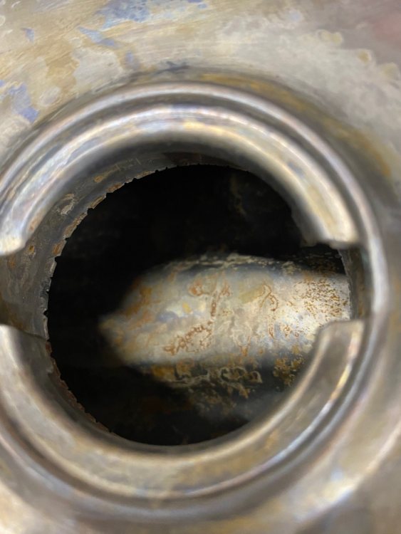

hi, i was to excited to start the process of coating my new motorcycle fuel tank and i use the rust blast instead of the degreasser.
i mixed it 1/1 with water and had it sitting for a day in the tank and now rust spots have appeared.
DUMB me. oh well i just got to fix the issue now.
what would be the simplest way to fix everything?
Your best bet at this point is to be another quart of RustBlast and start the process over. You need to clean the tank before you etch the tank.
