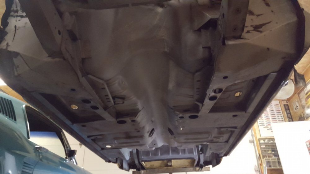

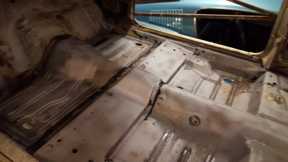

July 22, 20206 yr comment_5155 Hello, I had my car blasted yesterday by the people from Dustless Blasting. It looks great and they used some 'rust inhibitor' they said. But there is flash rusting in some areas. So I have two questions. Is there 'rust inhibitor' going to be a problem? I bought the KBS Kleen product as well, but I am trying to get this right the first time. So specifically my two questions are: Can the Fusion be applied over some flash rusting and will it seal it and adhere properly? Do I need to use the KBS Kleen on the metal first, and does it require I scub until some specific point? Ok, so lets make it three questions: Are there any restrictions on what I put over this stuff. My intention is white epoxy primer followed by a color coat? Thanks a million Link to comment https://success.kbs-coatings.com/topic/2867-fusion-over-blasted-metal-flash-rust/ Share on other sites Share on X Share on Facebook {lang="reddit_text" Share via email Share on Pinterest More sharing options... Report Share this post
July 23, 20206 yr comment_5156 Best practice would be to wipe down the surface with KBS Klean and then apply your dust coat of Fusion Self-Etch Primer. Please let us know if that helps and if you have any additional questions. Link to comment https://success.kbs-coatings.com/topic/2867-fusion-over-blasted-metal-flash-rust/#findComment-5156 Share on other sites Share on X Share on Facebook {lang="reddit_text" Share via email Share on Pinterest More sharing options... Report Share this post
July 24, 20206 yr Author comment_5157 Perfect, my order from you included the KBS Klean, Fusion, and Thinner so I can spray it. So I don't have to worry about the flash rust as long as I wipe it down with the KBS Klean and a scotch bright pad? I appreciate the response. Link to comment https://success.kbs-coatings.com/topic/2867-fusion-over-blasted-metal-flash-rust/#findComment-5157 Share on other sites Share on X Share on Facebook {lang="reddit_text" Share via email Share on Pinterest More sharing options... Report Share this post
July 24, 20206 yr comment_5160 To minimize flash rust, dry the surface quickly and immediately. That is the key. Please let us know if you have any additional questions. Link to comment https://success.kbs-coatings.com/topic/2867-fusion-over-blasted-metal-flash-rust/#findComment-5160 Share on other sites Share on X Share on Facebook {lang="reddit_text" Share via email Share on Pinterest More sharing options... Report Share this post
