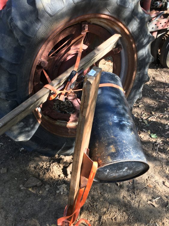

October 11, 20197 yr Author comment_4767 Thank you! Found some MEK at the commercial paint store (hardware stores only carry substitute) and it seemed to be working, until my agitator suffered a catastrophic failure.... Link to comment https://success.kbs-coatings.com/topic/2661-methylene-chloride/#findComment-4767 Share on other sites Share on X Share on Facebook {lang="reddit_text" Share via email Share on Pinterest More sharing options... Report Share this post
