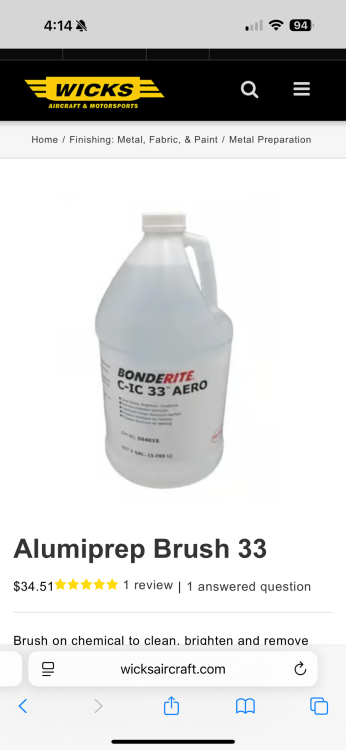

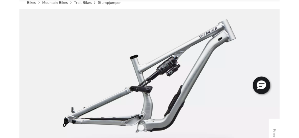

September 15, 2025Sep 15 comment_9944 This would be raw/bare aluminum. After sandblasting the bike frame, this Alumiprep 33 was recommended to clean and get some original shine back without polishing. Then add the diamond clear. I don’t want a “shiny” bike. But protected from elements, rocks, etc. Link to comment https://success.kbs-coatings.com/topic/2479-diamond-clear-matt-finish/#findComment-9944 Share on other sites Share on X Share on Facebook {lang="reddit_text" Share via email Share on Pinterest More sharing options... Report Share this post
