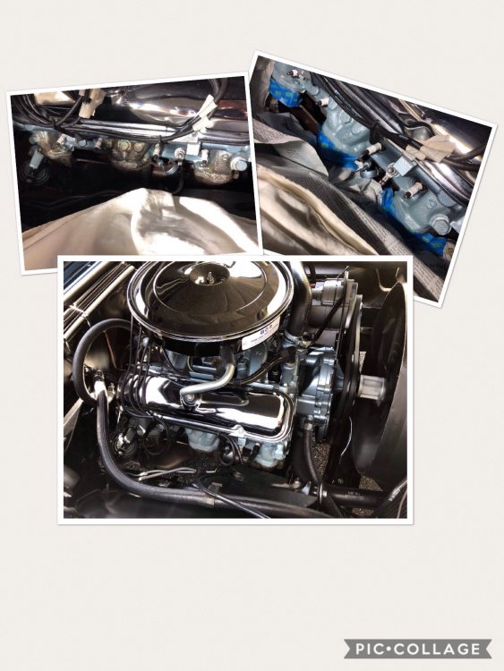

silverbullet07 Posted April 29, 2018 Author Report Share Posted April 29, 2018 Thought I would update and let you know I got the exhaust ports painted. The paint shade is a little different from my other Pontiac Blue Metalic however I think the color will work with it. I have gone through the curing process. I let it idle for about 40 min. The center port got up to 450 +- the other ports get about 350 +- at idle. It want been driven for another week to see the full potential of your paint generally the paint cooks of after the first ride so I'll update again. That i I would add a before after photo. Quote Link to comment https://success.kbs-coatings.com/topic/2270-xtream-temperture-coating-on-cast-iron-heads/#findComment-4213 Share on other sites More sharing options...
KBS Coatings Posted April 29, 2018 Report Share Posted April 29, 2018 It is looking good. Thanks for posting the picture! Quote Link to comment https://success.kbs-coatings.com/topic/2270-xtream-temperture-coating-on-cast-iron-heads/#findComment-4214 Share on other sites More sharing options...
