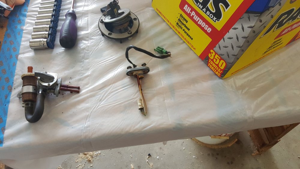

I have a cycle tank where the fuel level sending unit and the pick up tube are part of removeable pieces. this pieces fit in throw every precise fit. I want to use the old ones as "plugs/models" and coat them with natural carnauba wax or a model release agent.
That sounds like a good idea. Tank Sealer will not stick to oily surfaces and silicone waxy surfaces.
