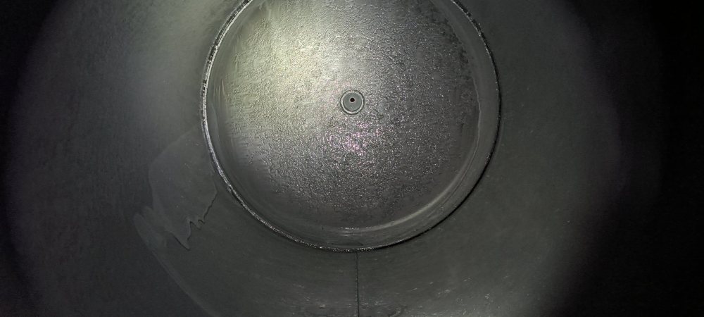

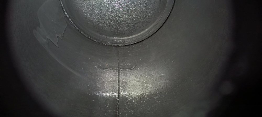

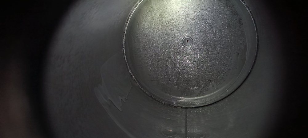

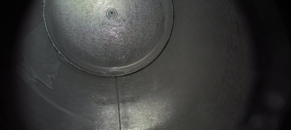

KyCarNut Posted October 10 Author Report Share Posted October 10 It appears to be well coated but I would value your professional opinion. It just seems like such a waste of product seeing as it cannot be stored and reused. Quote Link to comment https://success.kbs-coatings.com/topic/7261-how-much-product-should-remain-in-the-tank/#findComment-10023 Share on other sites More sharing options...
KBS Coatings Posted October 11 Report Share Posted October 11 Yes, from the pictures, that looks like the tank was coated nicely with Tank Sealer. Quote Link to comment https://success.kbs-coatings.com/topic/7261-how-much-product-should-remain-in-the-tank/#findComment-10026 Share on other sites More sharing options...
