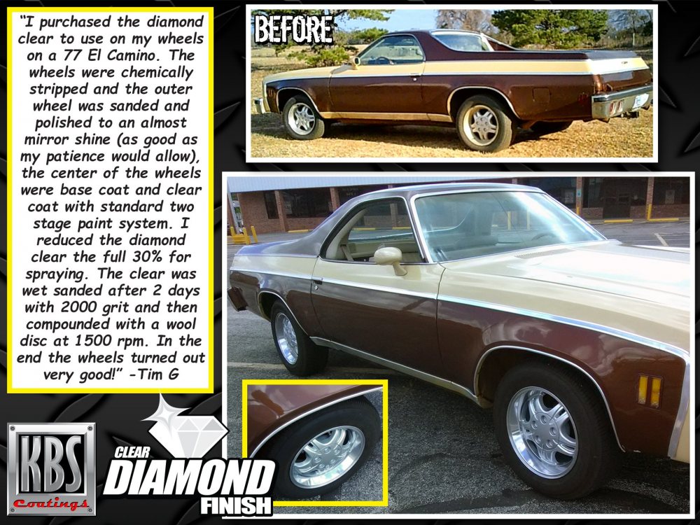

Clear Coated El Camino Wheels
“I purchased the diamond clear to use on my wheels on a 77 El Camino. The wheels were chemically stripped and the outer wheel was sanded and polished to an almost mirror shine (as good as my patience would allow), the center of the wheels were base coat and clear coat with standard two stage paint system. I reduced the diamond clear the full 30% for spraying. The clear was wet sanded after 2 days with 2000 grit and then compounded with a wool disc at 1500 rpm. In the end the wheels turned out very good!” -Tim G
