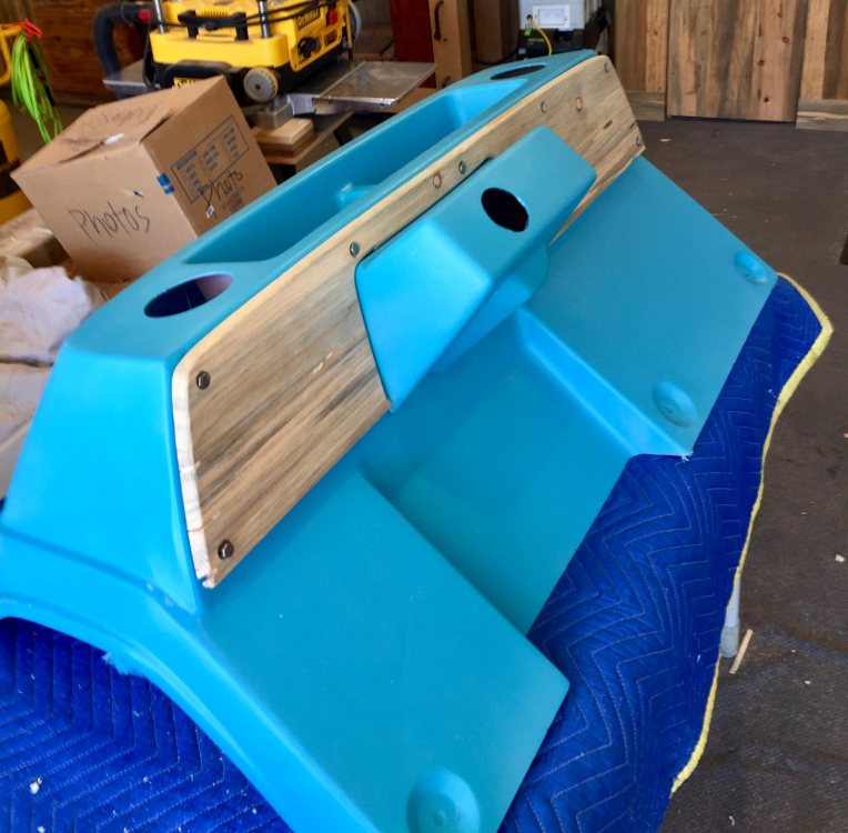

 I’m a novice at this.  I’ve ordered Diamond Clear and I read the directions online .  My question is "when" can it be  applied  over a Summit Racing Single Stage Acrylic Urethane Paint.
Presently I have three color coats on a fiberglass golf cart body.  The body was sanded and primed with Eastwood “Contour” polyester primer. Great product.  However, I’m not quite happy with the single stage color finish.  Hence I ordered your Clear Diamond Coat   The color coat has a 15 minute flash time and it recoated nicely.  (coat #1, wait 20min. coat #2 wait 20min…) I know that I must sand if the coating has cured.  Same with your product.
Here’s my question.  Now that the color coat has cured I’d like to know if I can sand the color coat, apply one or two more color coats then  shoot the KBS Diamond Clear after the color coat flash time. 20 minutes.
