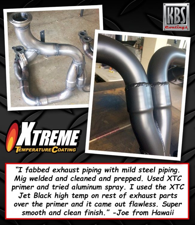

  2. “I fabbed exhaust piping with mild steel piping. Mig welded and cleaned and prepped. Used XTC primer and tried aluminum spray. I used the XTC Jet Black high temp on rest of exhaust parts over the primer and it came out flawless. Super smooth and clean finish.” -Joe from Hawaii High Temperature Paints from KBS Coatings
