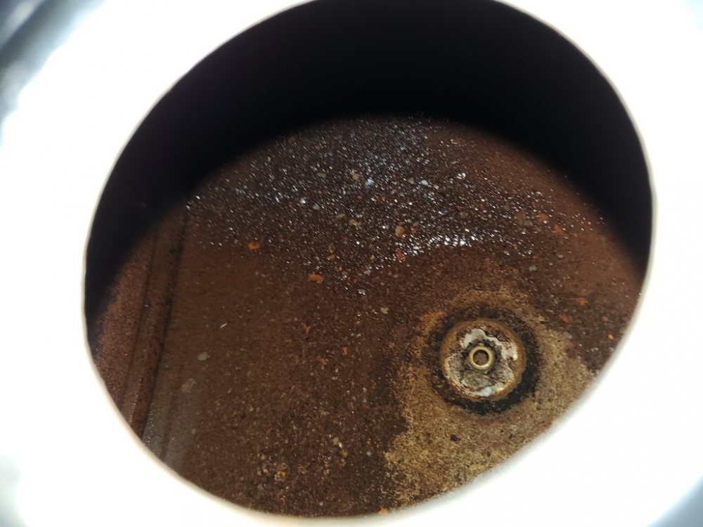

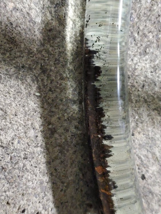

August 19, 20206 yr comment_5178 Cleaning and Rusty gas tank in a 1930 Chevrolet. I have used other KBS Products on my restoration so looking here first for a solution. plan to remove the tank, clean it out with KBS Clean and then use the Rust Blast to clean and remove the rust inside. then rinse with water as always. question is can i then use the tank as is with OUT a coating/liner ?? not really keen on using a liner in a gas tank. my concern is flash rust or rust returning in general ?? not sure if the zinc phosphate coating would be a good protector with the gasoline/ethanol blends. open to options Link to comment https://success.kbs-coatings.com/topic/2880-rust-blast-for-cleaning-tank/ Share on other sites Share on X Share on Facebook {lang="reddit_text" Share via email Share on Pinterest More sharing options... Report Share this post

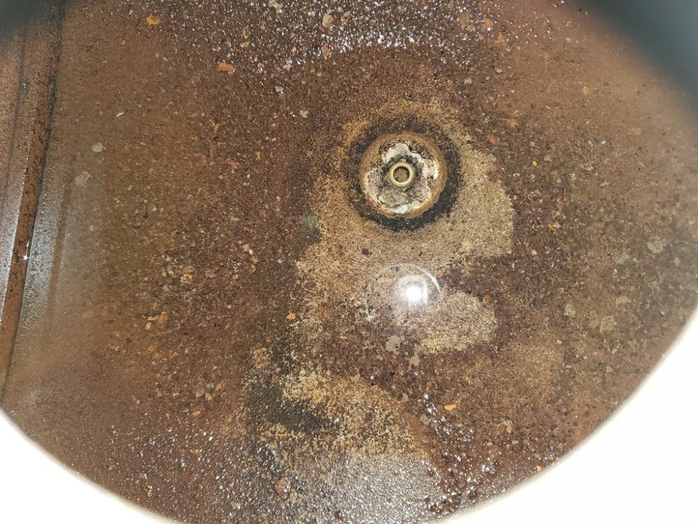

August 23, 20206 yr Author comment_5185 great, I did step one then step two, when doing step 2 about 95 of the surface was metal and very little sections of rust. looked very good, as soon as i rinsed it started to flash rust all over there was no lag time i was flashing before i could even start to dry it ? is this normal or how to i prevent or stop the flash rust ?? Link to comment https://success.kbs-coatings.com/topic/2880-rust-blast-for-cleaning-tank/#findComment-5185 Share on other sites Share on X Share on Facebook {lang="reddit_text" Share via email Share on Pinterest More sharing options... Report Share this post
August 23, 20206 yr comment_5186 Yes, that is very normal unless you live in a no humidity environment like the desert. To minimize this flash rust if you desire, force dry the tank as soon as you finish rinsing the RustBlast. Please feel free to reach out to us if you have any additional questions. Link to comment https://success.kbs-coatings.com/topic/2880-rust-blast-for-cleaning-tank/#findComment-5186 Share on other sites Share on X Share on Facebook {lang="reddit_text" Share via email Share on Pinterest More sharing options... Report Share this post
August 24, 20206 yr Author comment_5187 ok, yes once it was rinsed i used my blower to blow it out and dry it quickly. is minimal flash rust assume it is ok to continue on and coat ? Link to comment https://success.kbs-coatings.com/topic/2880-rust-blast-for-cleaning-tank/#findComment-5187 Share on other sites Share on X Share on Facebook {lang="reddit_text" Share via email Share on Pinterest More sharing options... Report Share this post
August 24, 20206 yr comment_5188 Yes, minimal flash rust (which is mixed with the zinc phosphate and probably mostly zinc phosphate) is perfectly fine and the zinc phosphate aids in the adhesion of the Tank Sealer. Please reach out if you have any additional questions. Link to comment https://success.kbs-coatings.com/topic/2880-rust-blast-for-cleaning-tank/#findComment-5188 Share on other sites Share on X Share on Facebook {lang="reddit_text" Share via email Share on Pinterest More sharing options... Report Share this post
